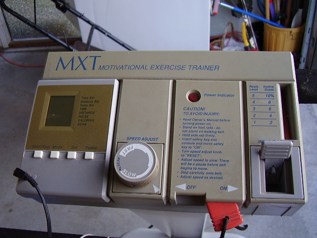

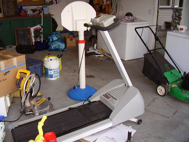

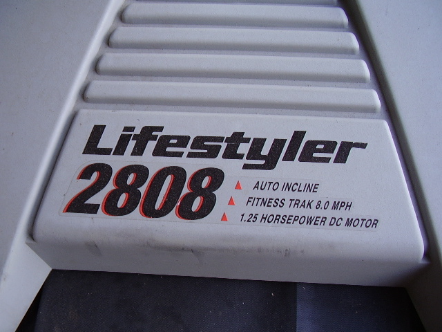

I picked this up for free, works well, just need to know how to adapt it to my sander.

I`ve been kicking around an idea of putting a rubber roller on the outfeed side of the drum with a crank so you can "feel" the load on the machine. This way you could also get the piece through the machine quicker should you get in a jam.
Rod, looks like you have a good idea with the treadmill, but what are ya gonna hang your dirty clothes on now?

Rod; There should certainly be enough gear in that machine for an excellent system. Make sure you don't toss out the wiring diagram. It'll probably be on an inpection panel somewhere.

Hey Rod, I think you have a good thing with that treadmill. I wouldn't worry about altering it. Just remove the "handles" and all the plastic junk and you've got a nice long infeed bed. The tracking is already set on the thing so I'd use it as it is. Just build the sander around it.
PostPosted: Tue Feb 07, 2006 3:04 am
Nice idea Paul, but the bad thing about it is that my sander is already built (you probably knew this), your right though.
